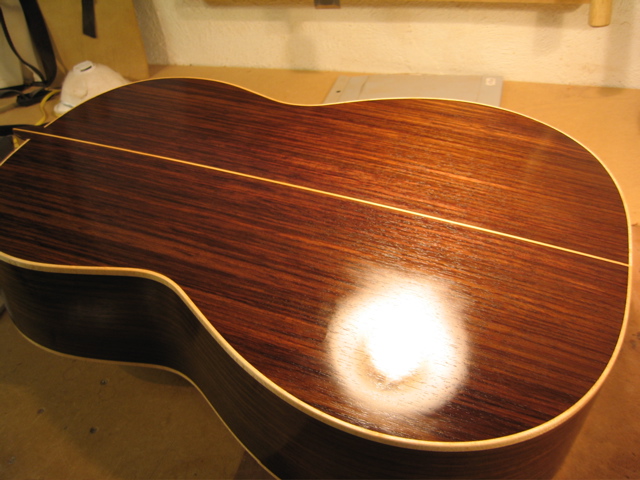

I do quite like the look of flamed maple, ergo using it on my first. Nothing too heavily flamed, just something pleasant looking:

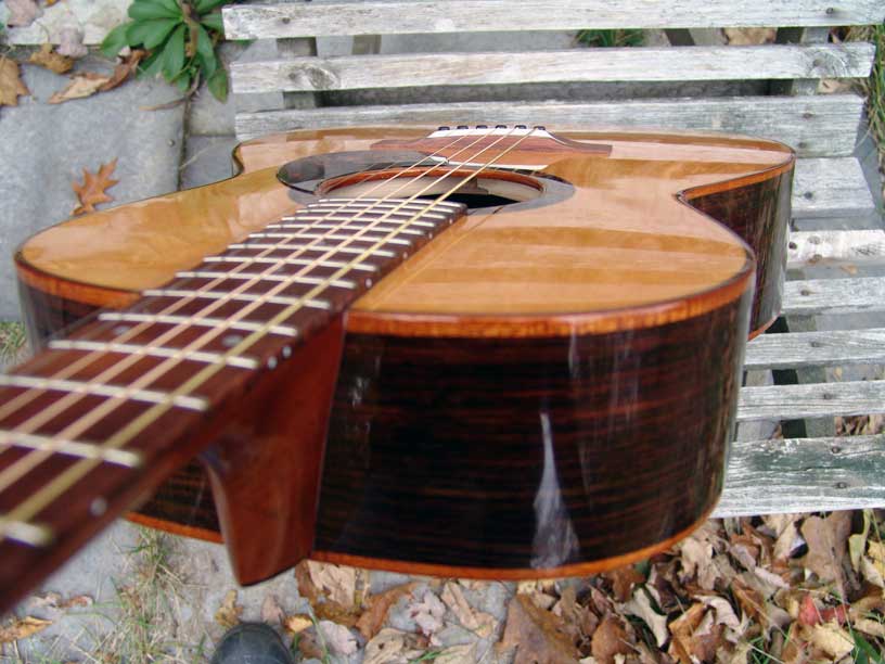

PostPosted: Sat Jan 14, 2006 1:31 am
Curly koa with EIR is one of my favorites. My best looking OM that I have built has that combination and I really like the look of it.

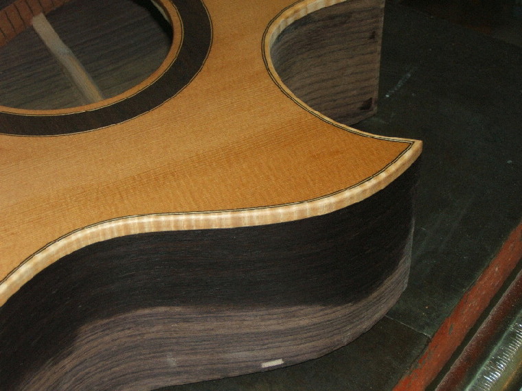

Serge,
Here's one I am working on with Flamed maple with BWB top perfling. No side perfling here, those compound miters at the cutaway scare me at this point (no pun intended)
I agree with Larry that plane maple is boringish for a wood binding.
